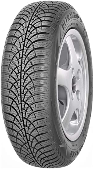

    [TD=width: 540px]2nd: Goodyear UltraGrip 9
    Total: 427 / Dry: 111 / Wet: 141 / Snow: 140 / Rolling Resistance: 20 / Comfort: 8 / Noise: 7
    Dry: Good braking but a little understeer in the dry. Good rolling resistance and comfort
    Wet: Very strong braking and aquaplaning results
    Snow: Short stopping distances and good traction with the new Ultra Grip 9
    Overall: Very good debut, on the podium for the new Ultra Grip 9 Goodyear
