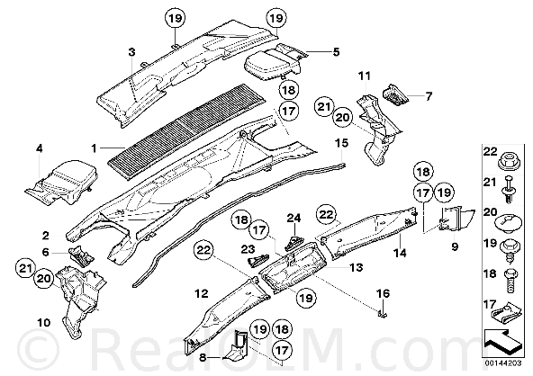

    [TABLE]

    [TR]
    [TD="class: r10, bgcolor: #D2ADDC"]01[/TD]
    [TD="class: r11 i0, bgcolor: #ADDCB3"]MICROFILTRO[/TD]
    [TD="class: r10 p1, bgcolor: #D2ADDC"][/TD]
    [TD="class: r11, bgcolor: #ADDCB3"]1[/TD]
    [TD="class: r10, bgcolor: #D2ADDC"][/TD]
    [TD="class: r11, bgcolor: #ADDCB3"][/TD]
    [TD="class: r10, bgcolor: #D2ADDC"]64319313517[/TD]
    [TD="class: r11, bgcolor: #ADDCB3, align: right"][/TD]
    [TD][/TD]
    [/TR]
    [TR]
    [TD="class: r00, bgcolor: #F8EDFF"]02[/TD]
    [TD="class: r01, bgcolor: #CFFFD8"]Carter microfiltro, parte inferiore[/TD]
    [TD="class: r00 p1, bgcolor: #F8EDFF"][/TD]
    [TD="class: r01, bgcolor: #CFFFD8"]1[/TD]
    [TD="class: r00, bgcolor: #F8EDFF"][/TD]
    [TD="class: r01, bgcolor: #CFFFD8"][/TD]
    [TD="class: r00, bgcolor: #F8EDFF"]64316989788[/TD]
    [TD="class: r01, bgcolor: #CFFFD8, align: right"][/TD]
    [TD][/TD]
    [/TR]
    [TR]
    [TD="class: r10, bgcolor: #D2ADDC"]03[/TD]
    [TD="class: r11, bgcolor: #ADDCB3"]Carter microfiltro, parte superiore[/TD]
    [TD="class: r10, bgcolor: #D2ADDC"]64316987498[/TD]
    [TD][/TD]
    [/TR]
    [TR]
    [TD="class: r00, bgcolor: #F8EDFF"]04[/TD]
    [TD="class: r01, bgcolor: #CFFFD8"]Copertura sinistra[/TD]
    [TD="class: r00, bgcolor: #F8EDFF"]64316925017[/TD]
    [TD][/TD]
    [/TR]
    [TR]
    [TD="class: r10, bgcolor: #D2ADDC"]05[/TD]
    [TD="class: r11, bgcolor: #ADDCB3"]Copertura destra[/TD]
    [TD="class: r10, bgcolor: #D2ADDC"]64316925018[/TD]
    [TD][/TD]
    [/TR]
    [TR]
    [/TR]
    [/TABLE]

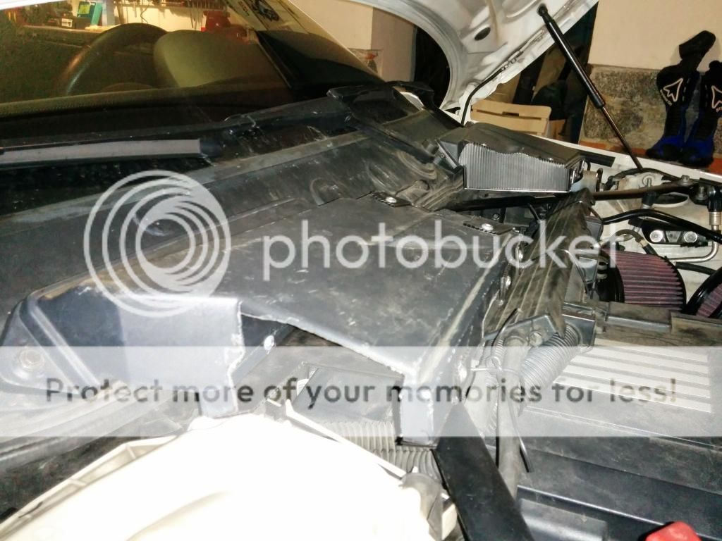

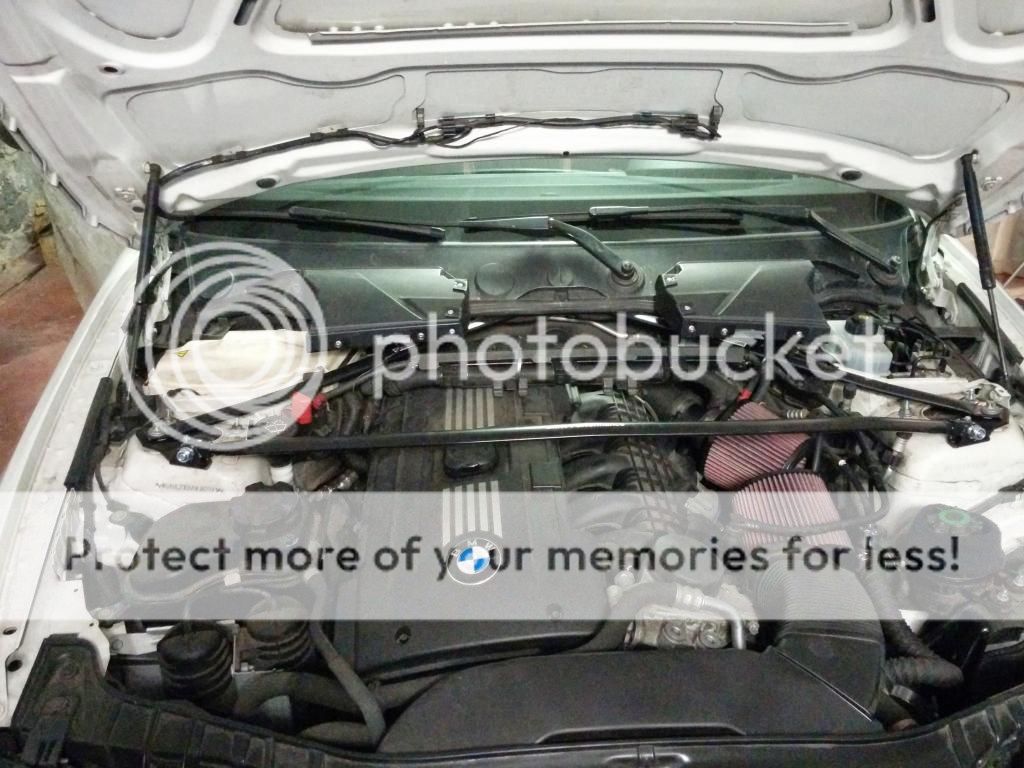

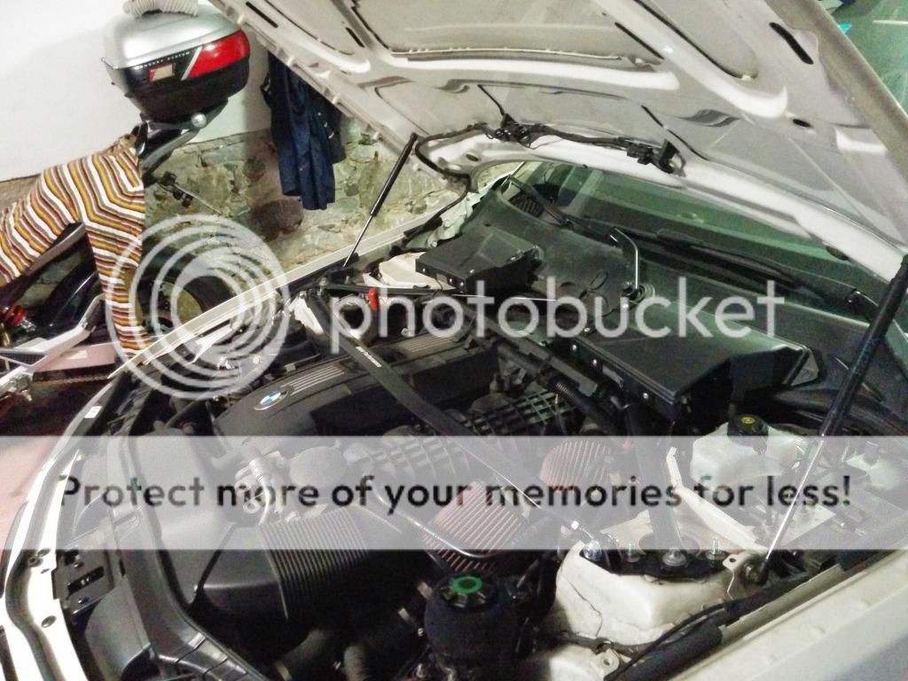

    Non volendo rinunciare al raffreddamento del vano motore ho deciso di fare questa modifica in modo da riparare dall'acqua i filtri della Burger Tuning:
    [​IMG][​IMG]
    [​IMG][​IMG][​IMG]
    I filtri della Burgher Tuning sono stati tagliati e profilati nei bordi in modo da poter montare sopra il carter microfiltro tagliato e opportunamente rivestito in modo da far prendere aria fresca ai lari del motore.
    Molto soddisfatto della modifica!!
