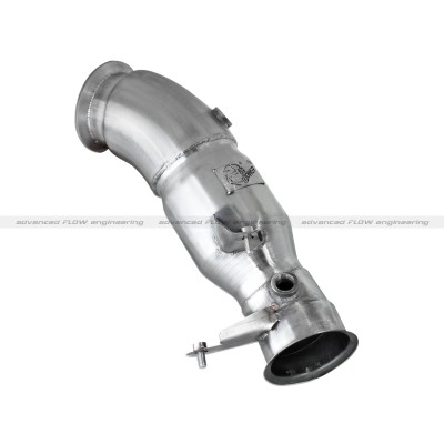

    interessante questo AFE
    diametro ben 100mm !!
    300 celle
    ottima realizzazione costruttiva
    no spie ceck
    aFe is proud to introduce the aFe Twisted Steel® Down-Pipe with a 300 CPSI high-flow catalytic converter for the 2012-2014 BMW F30 335i with the L6-3.0L (N55) engine. In testing this system resulted in a max gain of 10 horsepower and 16 lbs. x ft. of torque and outflowed the restricted OE catalytic converter by up to 150%. This high performance down-pipe delivers the perfect balance of pure, race-inspired performance, in-cabin driving comfort and the excitement of exhaust sound and tone during normal cruising or aggressive hard throttle. aFe also included a massive, lightweight, 4" diameter, 304 stainless steel tube with a 300 CPSI, high-flow catalytic converter. The catalytic converter is not only environmentally friendly it also prevents check engine lights.
    Tig-Welded:
    100% TIG-Welded by certified craftsmen for race proven strength and durability. TIG-Welding provides the strongest welds reducing stress cracks.
    High-Flow Catalytic Converter:
    This system uses a 49 state legal 300 cell per square inch (CPSI) stainless steel high-flow catalytic converter designed for maximum flow and performance while preventing a check engine light.
    Factory O2 Sensor Locations:
    Factory mounting locations for all O2 sensors.
    Hassle-Free Installation:
    OE style brackets are included for a hassle-free installation. This unit also comes with a lifetime warranty.
    Also Fits: 2014 BMW 435i (F32) L6-3.0L (t) N55
    2014 BMW M235i (F22) L6-3.0L (t) N55
    aFe down pipes are engineered and manufactured in our Corona, California manufacturing facility.
    Note: This is a "Race Only" product used solely for competition. Its use is limited to closed-course and open-course racing that is formally sanctioned by a recognized racing organization. Any other use including recreational off-road use could be in violation of local, state and federal laws.

    Per rispondere alle domande..1 nessuna spia sonda lambda con downpipe AFE.Mi sono orientato verso il catted piuttosto del catless proprio per non avere problemi oltre ad avere un comfort di marcia accettabile.Se dovessi avere problemi di spia in futuro basta allontanare la sonda od in casi estremi esistono dei dispositivi specifici che ingannano.
