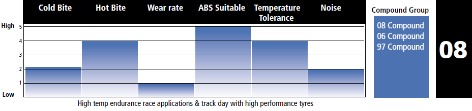

    come vi scrissi tempo indietro, in passato ho avuto le PFC08
    pastiglia a dir poco fantastica, no fischi e frenata a bomba
    per BMW M4 la Performance Friction produce due mescole
    la PFC08 e PFC11
    la PFC08 ho letto che è una delle più raccomandate sui forum esteri
    su eBay il kit completo a circa 600 euro
    https://www.ebay.it/sch/i.html?_odk...0.l1313&_nkw=BMW+M4+PFC+08+pastiglie&_sacat=0
    [​IMG]08 compound is one of PFC’s newest and has gained immediate favour in extended Endurance Sportscar, and GT racing due to its performance in applications where smooth initial bite is a must. 08 has a slight friction rise with temperature, excellent release and modulation characteristics. Very low disc wear, similar to 01. Despite its considerable performance, 08 has the lowest wear rate of all PFC compounds and can easily match the wear characteristics of the other competitor’s materials but with much higher bite.
