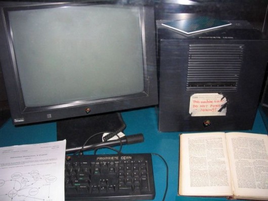

    --> http://www.cultofmac.com/225838/steve-jobs-created-the-computer-that-gave-us-the-world-wide-web/
